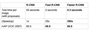

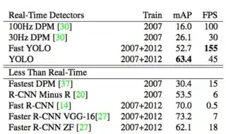

We are getting there, with as usual some trade-off between quality and speed.
For example Lecture 8: Spatial Localization and Detection lecture shows some benchmarks (mAP = Mean Average Precision, higher is better; FPS = frame per second):
Table/Performance: Real-Time Detectors
Table/Performance: R-CNN, Fast R-CNN, Faster R-CNN
