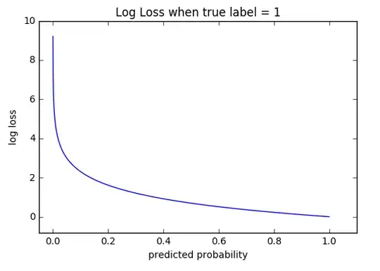

I mean you technically could (it's not going to break or something) however, cross entropy is much better suited for classification as it penalizes for misclassification errors: have a look at the function: when you are wrong the loss goes to infinity: enter image description here
you are either from one class or another. MSE is designed for regression where you have nuance: you get close to target is sometimes good enough. You should try both and you will see the performance will be much better for the cross entropy.
