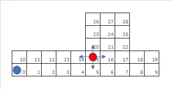

tag-game
The tag game: the robot (blue) and target on a map with 29 positions and 870 states (29 for the robot, 29 + 1 (tagged) for the target).
