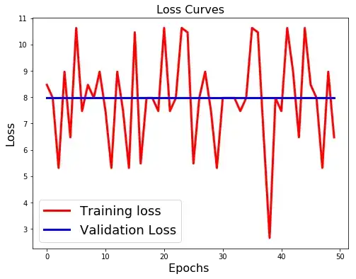

I tried to create a simple model that receives an $80 \times 130$ pixel image. I only had 35 images and 10 test images. I trained this model for a binary classification task. The architecture of the model is described below.

What could the oscillating training loss curve represent above? Why is the validation loss constant?

As it has already been observed, your main problem, beside the training related issues like fixing the learning rate, is you have basically no chance to learn such a big model woth such a small dataset ... from scratch

Try lowering the learning rate.
Such a loss curve can be indicative of a high learning rate. Due to a high learning rate the algorithm can take large steps in the direction of the gradient and miss the local minima. Then it will try to come back to the minima in the next step and overshoot it again.
You may also try switching to a momentum-based GD algorithm. Such a training loss curve can be indicative of a loss contour like in this example, for which momentum-based GD methods are helpful.
I noticed that you have a very small training set. You may have better luck with a larger training data (~1000 examples) or using a pre-trained Conv network as a starting point.

From my experience, this oscillation comes from:
  • Too high learning rate: Weights change too quick.
  • Too few neurons in layers: Not enough to fit.
    • When having not enough neurons, the network can't learn at all and the oscillation is due to failure to fit to global optimum; it's correct for some cases and wrong on other cases
