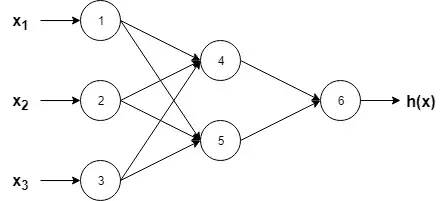

In order to get the gradients, we express the above function as a neural network as follows: enter image description here
Let's calculate the gradient, say w.r.t. $w_{14}$.
$$\frac{\partial J}{\partial w_{14}} = \sum_{i=1}^N \Big[\big(h(x^{(i)})-y^{(i)}\big)\frac{\partial h(x^{(i)})}{\partial w_{14}}\Big]$$ Let $p(x) = w_{14}x_1+w_{24}x_2+w_{34}x_3+b_4$ , and
Let $q(x) = w_{46}\times\sigma(p(x))+w_{56}\times\sigma(w_{15}x_1+w_{25}x_2+w_{35}x_3+b_5)+b_6)$
$\therefore \frac{\partial h(x)}{\partial w_{14}} = \frac{\partial h(x)}{\partial q(x)}\times\frac{\partial q(x)}{\partial p(x)}\times\frac{\partial p(x)}{\partial w_{14}} = \frac{\partial\sigma(q(x))}{\partial q(x)}\times\frac{\partial\sigma(p(x))}{\partial p(x)}\times\frac{\partial p(x)}{\partial w_{14}}$
We see that the derivative of the activation function is important for getting the gradients and so for the learning of the neural network. A constant derivative will not help in the gradient descent and we won't be able to learn the optimal parameters.
