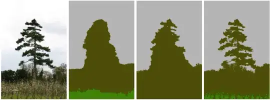

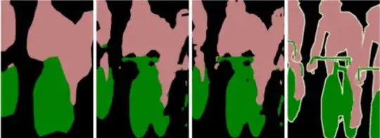

What the author refers to is the level of detail of the resulting segmentation.
A coarse segmentation would mean that we have large blobs covering each class without much detail. On the other hand, a fine segmentation would have a much higher level of detail which can even go down to pixel level (i.e. pixel-by-pixel correct segmentation).
To make this clear look at the following two examples. As we go from the left to right, the segmentation maps go from coarse to fine:
Note that in the rightmost images the result an almost pixel-perfect (i.e. fine details) segmentation map, while the ones on the left don't have much detail and can be considered coarse.
