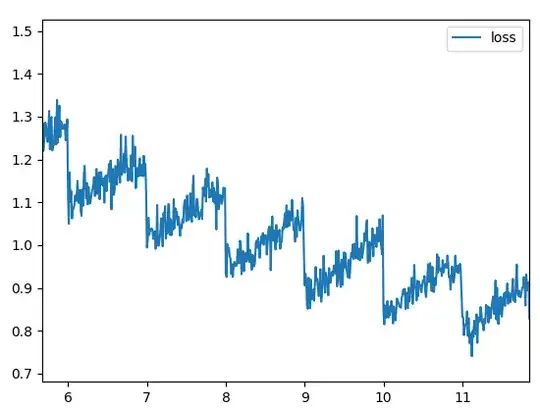

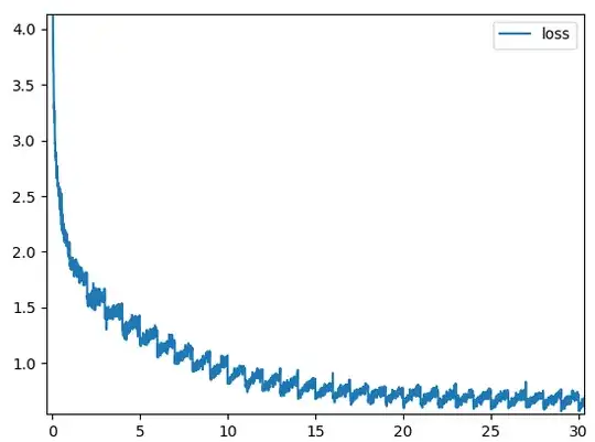

I'm training a text classifier in PyTorch and I'm experiencing an unexplainable cyclical pattern in the loss curve. The loss drops drastically at the beginning of each epoch and then starts rising slowly. However, the global convergence pattern seems OK. Here's how it looks:
loss curve (global)loss curve (zoom)
The model is very basic and I'm using the Adam optimizer with default parameters and a learning rate of 0.001. Batches are of 512 samples. I've checked and tried a lot of stuff, so I'm running out of ideas, but I'm sure I've made a mistake somewhere.

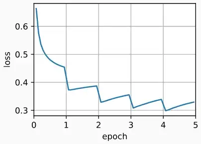

It turns out that the zig-zag pattern is an inherent effect of using a word embedding layer. I don't fully understand the phenomenon, but I believe it has a strong correlation with the embeddings acting as a sort of memory slots, which can change relatively quickly, and the LSTM generating a summary of the sequence, so that the model can remember past combinations.
I found this plot of a training loss curve of word2vec and it exhibits the same per-epoch pattern.
word2vec loss
Edit
After conducting several experiments, I've isolated the causes. It seems that this is an indirect effect of having a large model capacity. In my case, I had too large word embeddings (size 1024) and too many classes (2002), which also increases model capacity, so the model was doing an almost per-sample learning. Reducing both resulted in a smooth-as-silk learning curve and a better generalisation.
