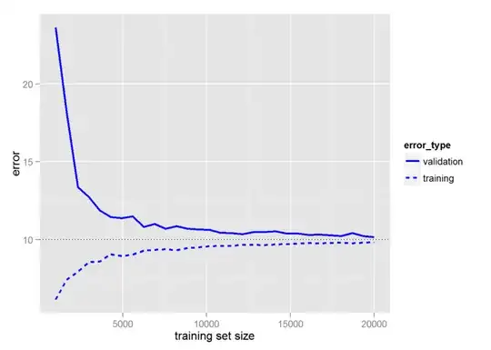

For a finite value to be 'optimal,' typically you need some benefit from more paired up with some cost for more, and eventually the lines cross because the benefit decreases and the cost increases.
Most models will have a reduction in error with more training data, that asymptotically approaches the best the model can do. See this image (from here) as an example:
Decreasing error with increasing training set size
The costs of training data are also somewhat obvious; data is costly to obtain, to store, and to move. (Assuming model complexity stays constant, the actual cost of storing, moving, and using the model remains the same, since the weights in the model are just being tuned.)
So at some point the slope of the error-reduction curve becomes horizontal enough that more data points are costlier than they're worth, and that's the optimal amount of training data.
