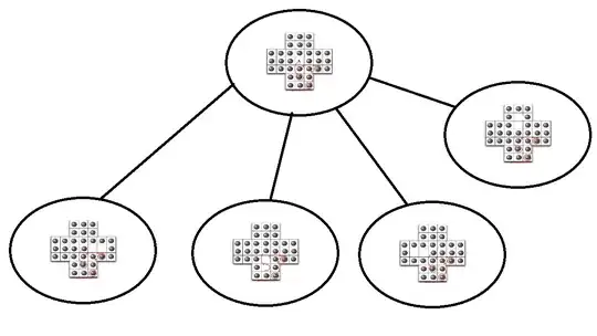

I had the idea of converting the problem to a tree where each node represents the state after an action is taken and each edge represents the action taken. So the root node would the initial state which is the board shown above then it's children would be the state of the board after any of the possible legal actions that can be taken.
So, for example:
Then the children of each of those nodes would be the possible moves for them and you can find a solution once you've reached depth 31 in the tree because there are 32 pegs and you win the game where there's only 1 left.
Is this the right approach? It feels a little too abstract because I'd have to represent the edges as peg moves, but that's weird cause they're usually numbers or constraint.

Your approach seems reasonable to me. The edges do not necessarily have to be numbers, but, if you wish, you could also encode the actions as numbers. For example, the weight of an edge could represent the "cost" of the corresponding action. If there's no natural cost associated with an action, then you can add a unit cost for each action.
