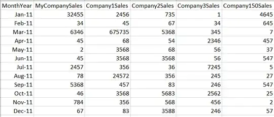

I have a dataset as follows
(and the table extends to include an extra 146 columns for companies 4-149)
Is there an algorithm I could use effectively to find similar patterns in sales from the other companies when compared to my company?
I thought of using k-means clustering, but as I'm dealing with 150 companies here it would likely become a bit of a mess, and I don't think linear regression would work here.
