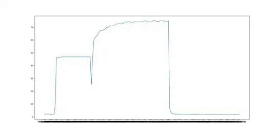

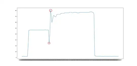

I use the following code to plot a graph.
Code:
lineplot = X.loc[X['ContextID'] == 7290057]
x_axis = lineplot.values[:,3]
y_axis = lineplot.values[:,1]
plt.figure(1) plt.plot(x_axis, y_axis)
and the graph: enter image description here
In this graph, the peaks (marked in red circles) are the anomalies that need to be detected.
And when I have a graph like this: No anomalies must be caught since there are no undesirable peaks.
I tried using OneClassSVM, but I am somehow not satisfied with the results.
I would like to know which unsupervised learning algorithm can be used for such a task at hand.

some_programmer
  • 225
If your anomalies are simply peaks, why should you be using machine learning methods? You could use peak detection algorithms for the purpose.
If you still insist on ML, isolation forest is a good try.
