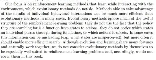

It seems that another rather controversial point is about the inclusion of evolutionary algorithms as Reinforcement Learning ones. Sutton & Barto do not. They argue that
Evolution vs Learning Sutton&Barto 20202
And also:
More evolution vs learning.
Other people related with the subject, as the HSE University that offers a course in Coursera, Maxim Lapan , or P. Palanisamy (both Packt's authors) include them into the subject. Apparently they support the idea that RL is defined by changes in performance resulting from interaction with the environment. For instance, Lapan classifies the cross-entropy method as model-free, policy-based and on -policy.
