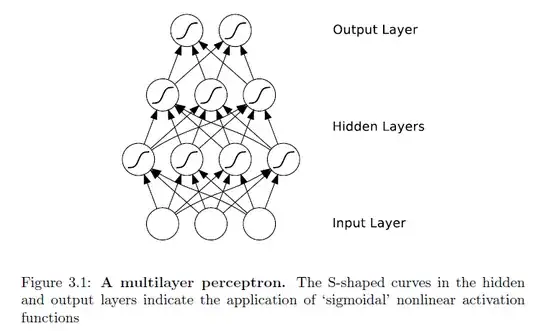

Difference with traditional Neural networks using pictures from this book:

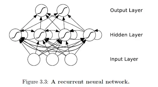

And, an RNN:
Notice the difference -- feedforward neural networks' connections do not form cycles. If we relax this condition, and allow cyclical connections as well, we obtain recurrent neural networks (RNNs). You can see that in the hidden layer of the architecture.
While the difference between a multilayer perceptron and an RNN may seem trivial, the implications for sequence learning are far-reaching. An MLP can only map from input to output vectors, whereas an RNN can in principle map from the entire history of previous inputs to each output. Indeed, the equivalent result to the universal approximation theory for MLPs is that an RNN with a sufficient number of hidden units can approximate any measurable sequence-to-sequence mapping to arbitrary accuracy.
