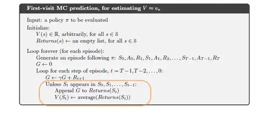

I've been trying to read Sutton & Barto book chapter 5.1, but I'm still a bit confused about the procedure of using Monte Carlo policy evaluation (p.92), and now I just cant proceed anymore coding a python solution, because I feel like I don't fully understand how the algorithm works, so that the pseudocode example in the book doesn't seem to make much sense to me anymore. (the orange part)
I've done the chapter 4 examples with the algorithms coded already, so I'm not totally unfamiliar with these, but somehow I must have misunderstood the Monte Carlo prediction algorithm from chapter 5.

    1. On page 92 it shows the algorithm pseudocode and I feel as though I coded my episode generating function correctly thusfar. I have it such that, the results are that I always start in the same starting state (1,1) coords in the gridworld.
    2. Currently, I have it so that if you started always in state (1,1), then a possible randomly generate episode could be as follows (in this case also optimal walk). Note that I currently have the episodes in form of list of tuple (s, a, r). Where s will also be a tuple (row,column), but a = string such as "U" for up, and r is reward always -1.
    3. so that a possible episode could be like: [( (1,1), "U", -1 ), ( (0,1), "L", -1 )] So that the terminal state is always excluded, so that the last state in episode will be the state immediately close to terminal state. Just like the pseudocode describes that you should exclude the terminal state S_T. But, the random episode could have been one where there are repeating states such as [( (1,1), "U", -1), ( (0,1), "U", -1 ), ( (0,1), "U", -1 ), ( (0,1), "L", -1 )]
    4. I made the loop for each step of episode, such as follows: once you have the episodeList of tuples, iterate for each tuple, in reversed order. I think this should give the correct amount of iterations there...
    5. G can be updated as described in pseudocode.
    6. currently the Returns(S_t) datastructure that I have, will be a dictionary where the keys are state tuples (row,col), and the values are empty lists in the beginning.
    7. I have a feeling that I'm calculating the average into V(S_t) incorrectly because I origianlly thought that you could even omit the V(S_t) step totally from the algorithm, and only afterwards compute for a separate 2D array V[r,c] for each state get the sum of the appropriate list elements (accessed from the dict), and divide that sum by the amount of episodes that you ran???
But I don't suddently know how to implement the first visit check in the algorithm. Like, I literally don't understand what it is actually checking for.
And furthermore I don't understand how the empirical mean is now supposed to be calculates in the monte carlo algorithm where there is the V(s_t) = average( Returns(S_t) )
I will also post my python code thusfar.
