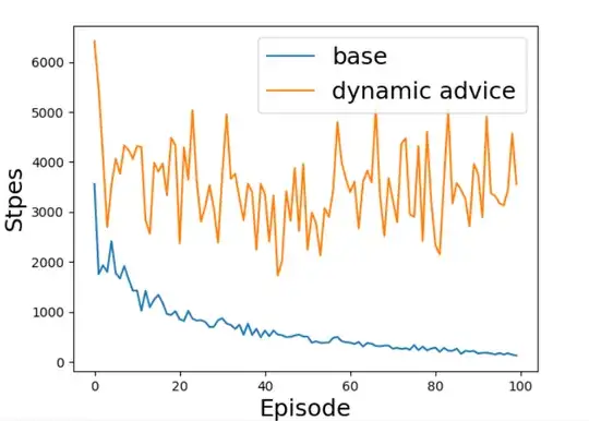

I am trying to reproduce the results for the simple grid-world environment in [1]. But it turns out that using a dynamically learned PBA makes the performance worse and I cannot obtain the results shown in Figure 1 (a) in [1] (with the same hyperparameters). Here is the result I got: enter image description here
The issue I found is that the learning procedure is stuck due to bad PBA in the early stages of training. Without PBA, Sarsa can converge well.
Did anyone try the method before? I am really puzzled and how the authors obtain these good results? There are some top conference papers using the same method in [1], for example, [2] and [3].

Is the method itself defective or anything wrong with my code? Here is part of my codes:
There does indeed appear to be an issue with the code, the publications are fine (I know most of those authors and would very much trust their writing too :) ).
The first issue I see, and likely the most important, is that the update() calls of DynamicPBA frequently update the contents of self.q_table to those of self.q_table_, but the contents of self.q_table_ are never updated. So, your q_table is essentially always filled with a bunch of $0$ values that never get a chance to properly learn.
I did not check the rest of the implementation in detail, but at a glance it all looks fine to me. So I guess that changing the last line of learn() to update an entry in self.q_table_ rather than self.q_table should go a long way towards fixing your issue.
