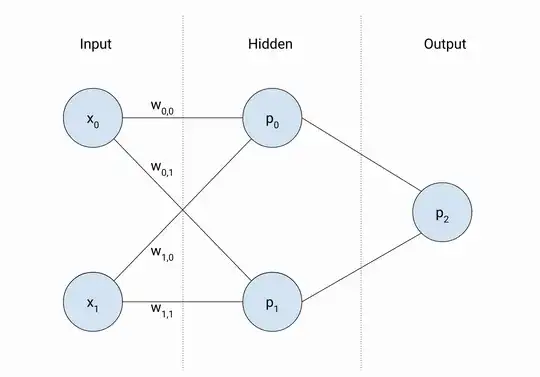

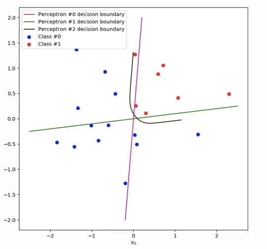

I've learned that you can use two perceptrons to ultimately create a classifier for non-linearly separable data. I'm trying to understand how / if these two perceptrons converge to two different decision boundaries though.
Source: https://tdb-alcorn.github.io/2017/12/17/seeing-like-a-perceptron.html
I don't understand how the second perceptron creates a different decision boundary when it has the same input as the first perceptron? I know the weights can be initialized differently but does this second perceptron classify something else? Shouldn't the decision boundaries be converge to be the the same ultimately after training?

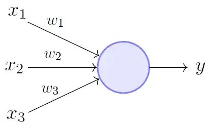

You should think of a perceptron as something like
A perceptron simply computes a linear combination of the inputs using the corresponding weights. A single perceptron can (only) linearly separate a set of points.
This is because the two perceptrons will eventually have different weights. You can see from your diagram that $p_0$ has weights $w_{0, 0}$ and $w_{0, 1}$, whereas perceptron $p_1$ has weights $w_{1, 1}$ and $w_{1, 0}$. Note that weights are learned, during training, depending on your loss function (at the output node $p_2$) and the labeled dataset (that you use to train that simple neural network).
If you consider the two hidden nodes (in your network) separately, then (as I said above) the output of these two hidden nodes can be interpreted as a line, and these lines might be different (as illustrated in your picture), because these two hidden nodes will eventually learn something different about the input. However, you should also think of the output of two hidden nodes as contributing to the input of the output node. So, in a certain way, you're combining the decisions of the two hidden nodes (or, as you call them, "perceptrons").
Note that you will need to introduce "non-linearity" in those hidden perceptrons in order to be able to non-linearly separate a set of points.
Shouldn't the decision boundaries both converge to the same ultimately after training?
No, not necessarily. The decision boundary found by the perceptron learning algorithm depends on the initialization of the weights and the order that the inputs are presented. See chapter 4 (specifically, pages 192-196) of Pattern Recognition and Machine Learning by C. Bishop. Two perceptrons would be guaranteed to converge to the same solution if the loss function was convex (i.e. there's only one optimum).
