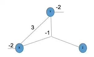

I think you would be interested in Neural-Symbolic Learning and Reasoning, a recent survey on the intersection between connectionist models (e.g. neural nets) and symbolic reasoning. It's a long paper, but it has a lot in it that is relevant to your question, if you're willing to dig. For example, it talks about learning networks that implement boolean logic.
This network searches for satisfying solutions for the weighted conjunctive normal form (CNF):$\text{(¬X ∨ ¬Y ∨ Z) ∧ (X ∨ Y )}$.
