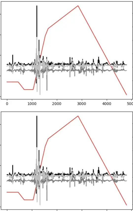

I wanted to ask whether it is possible for the network to nearly perfectly reconstruct the test timeseries when passed through the entire VAE network, but still output junk when using a random Normal input. For further details, here is one of the inputs and outputs when passing a test signal through the network.
inputs and outputs

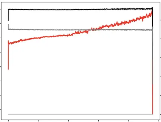

Here is a reconstruction generated purely from a random sample.
