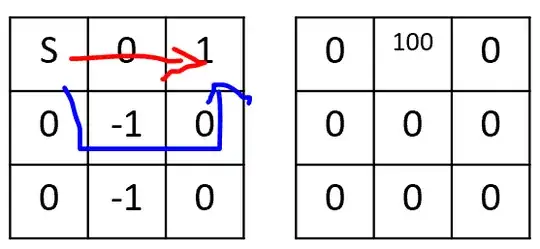

If I have the following setup:
  • on the left is my $R$.
  • on the right my potential function $\Phi(s)$
  • the top left is the start state, the top right is the goal state
The reward for the red route is: $(0 + (0.9 * 100 - 0)) + (1 + (0.9 * 0 - 100)) = -9$.
And the reward for the blue route is: $(-1 + 0) + (1 + 0) = 0$.
So, for me, it seems like the blue route is better than the optimal red route and thus the optimal policy changed. Do I have erroneous thoughts here?

The same $\gamma = 0.9$ that you use in the definition $F \doteq \gamma \Phi(s') - \Phi(s)$ should also be used as the discount factor in computing returns for multi-step trajectories. So, rather than simply adding up all the rewards for your different time-steps for the different trajectories, you should discount them by $\gamma$ for every time step that expires.
Therefore, the returns of the blue route are:
$$0 + (0.9 \times -1) + (0.9^2 \times 0) + (0.9^3 \times 1) = -0.9 + 0.729 = -0.171,$$
and the returns of the red route are:
$$(0 + 0.9 \times 100 - 0) + 0.9 \times (1 + 0.9 \times 0 - 100) = 90 - 89.1 = 0.9.$$
