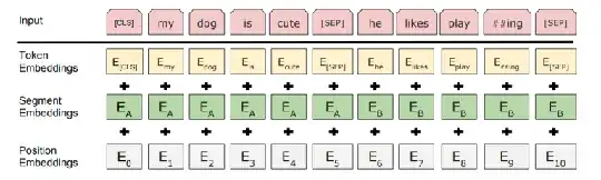

Sentences (for those tasks such as NLI which take two sentences as input) are differentiated in two ways in BERT:
  • First, a [SEP] token is put between them
  • Second, a learned embedding $E_A$ is added to every token of the first sentence, and another learned vector $E_B$ to every token of the second one
That is, there are just two possible "segment embeddings": $E_A$ and $E_B$.
Positional embeddings are learned vectors for every possible position between 0 and 512-1. Transformers don't have a sequential nature as recurrent neural networks, so some information about the order of the input is needed; if you disregard this, your output will be permutation-invariant.
These embeddings are nothing more than token embeddings.
You just randomly initialize them, then use gradient descent to train them, just like what you do with token embeddings.
