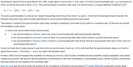

Here's a screenshot of part of Wikipedia article called "Einstein synchronization" included as evidence that what I wrote above is correct. I used a screen shot because copy pasting didn't work with the symbols. Sorry it's so small. Windows has a screen "magnifier" that may help (shortcut: press the equals sign key while holding down one of the Windows icon keys) or try right clicking in the image and selecting "open image in new tab" from the pop up menu.
Screen shot of part of the Wikipedia article called @Einstein sychronization
