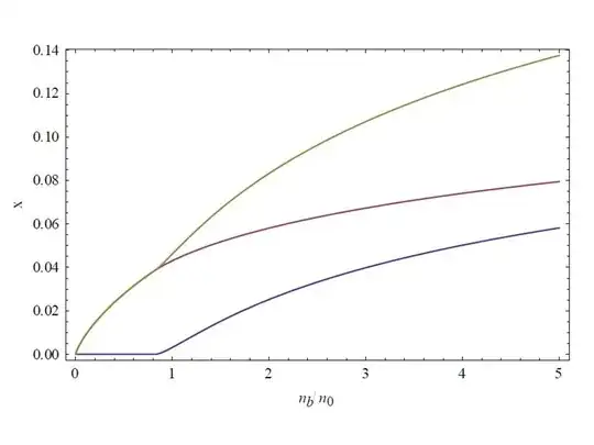

At densities above about $8\times 10^{17}$ kg/m$^3$, the Fermi energy of the electrons equals the rest-mass energy of muons (105 MeV) and muons can be produced. In more realistic models that include nucleon interactions, this occurs at about $3\times 10^{17}$ kg/m$^3$. The charge neutrality equation changes and the net result is that the number of protons in the gas is able to increase slightly - it could get above 10% of the neutron numbers, or even higher if negatively charged Hyperons are produced at even higher densities. This opens up a channel for the direct URCA process to occur.
The image below (taken from a thesis by Stephen Portillo) illustrates the proton (gold), electron (purple) and muon (blue) fractions as a function of baryonic density (in units of the nuclear saturation density $2.8\times10^{17}$ kg/m$^3$). This has been calculated incorporating nucleon interactions. The muons appear at about the saturation density and the proton fraction exceeds 1/8 at about $10^{18}$ kg/m$^3$.
Proton (gold), electron (purple) and muon (blue) fractions as a function of baryonic density in units of 2.8e17 kg/m^3
These reactions must involve neutrons, protons and electrons that are close to their Fermi energies (within about $kT$). Therefore this requirement on each species introduces an extra dependence of $\sim kT/E_F \ll 1$ per species into the reaction rate.
In the modified URCA process "bystander particles" are available to balance the momentum and energy equations - i.e. their role is just to provide sources/sinks of energy/momentum. However, the requirement for two more bystander nucleons (also within $kT$ of their Fermi energies) suppresses the reaction rate considerably (two more factors of $kT/E_F$ or about $10^6$ at typical densities). So, even though the modified process dominates over suppressed direct URCA at low densities, if densities are high enough for direct URCA to be possible, it dominates.
