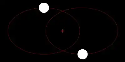

At the first level you explain that between two point charges there is an inverse square law. This is hard enough to grasp in high school but this relatively simple law can already tell a lot about the universe. The inverse square law not only occurs for static charges but also for gravity and the intensity of sunlight as a function of distance from the sun. Historically this was one of the first laws discovered concerning electricity if not the first.
At the second level you could imagine the inverse square law also works for moving charges. Then you get the following laws \begin{align} m_1\frac {d^2\mathbf r_1}{dt^2}&=k\frac{q_1q_2}{|\mathbf r_2-\mathbf r_1|^2} \mathbf{\hat r}_{12}\\ m_2\frac {d^2\mathbf r_2}{dt^2}&=k\frac{q_1q_2}{|\mathbf r_2-\mathbf r_1|^2}\mathbf{\hat r}_{21} \end{align} Here bold face means the variables are vectors. Also $\mathbf{\hat r}_{12}$ means the vector with length 1 pointing from charge 2 to charge 1. These laws are already very complicated but if you have two opposite charges (one positive, one negative) this is identical to gravity. For two bodies the result is known and the paths of the two charges are ellipses
Reality is even more complicated. The two laws I mentioned above are not true for moving charges, they are only approximations. In reality the two charges produce both electric and magnetic field and when they orbit they lose energy in the form of electromagnetic radiation. This means eventually they would spiral into each other. At the third level the force on a moving charge is given by the Lorentz law $$\mathbf F=q(\mathbf E+\mathbf v\times \mathbf B)$$ where $\mathbf E$ is the electric field, $\mathbf B$ the magnetic field and $\mathbf v$ the velocity of the charge. You would have to solve for the electric and magnetic field by solving Maxwell's equations.
This still isn't the complete picture so the take home message is that things get complicated very quickly and each level is only an approximation/special case of the more deeper level.
Source of image: https://en.wikipedia.org/wiki/Two-body_problem
