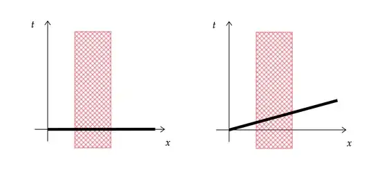

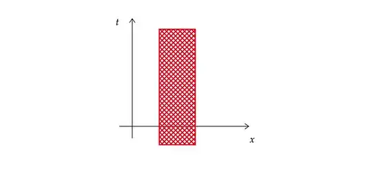

If you look at the spacetime diagram for the motion of an extended object, it traces our a worldsheet, not just a worldline. In its rest frame, the sheet looks like this.
To compute its rest length, we can take a spacelike slice of spacetime which represents a set of simultaneous events. This slice is a spatial submanifold which inherits a Riemannian metric, and the rest length of the object can be computed along that slice. So how do we choose a slice of simultaneity?
The obvious choice is the surface $t=\mathrm{const}$, but that's only true if your clocks are synchronized. In the previous example, the appropriate choice would be $t'=ax+\mathrm{const}$!
