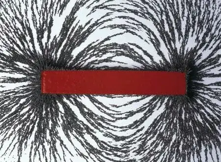

EDIT: Then why are there gaps between the iron filing lines? Is it because of my previous statement
because we assume that no magnetic field lines exist at places where the forces are very weak
And hence the iron filings align themselves to stronger field lines. Is this a reason why this terminology is still used?

why there are gaps between the the iron filling lines?
Iron filings are ferromagnetic. They don't just show the field, they change it.
...hence the iron filings align themselves to stronger field lines.
The filings self-organize into distinct lines because their presence concentrates the field. Magnetic field lines prefer to go through a ferromagnetic body rather than through empty space. The field actually is stronger inside the iron particles than in the gaps between them.
If you drop a new filing into the gap between two of the visible "lines," it will feel attraction toward either of the surrounding lines. It will only stay put, and become the seed for a new line, if the magnetic force that it feels is too weak to overcome the static friction between the particle and the paper (or whatever) underneath.
