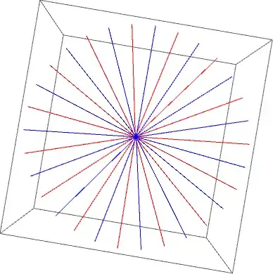

Here is an image of rays from two sources from side.

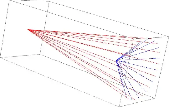

Compare that to an image of rays from the same two sources from base.
The particular perspective gives no information about the distance of the two sources.
