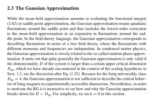

The mean-field approximation amounts to evaluating the functional integral for the partition function in saddle point approximation, while the Gaussian approximation retains quadratic fluctuations around the saddle point and thus includes the lowest-order correction to the mean-field approximation in an expansion in fluctuations around the saddle point.
The Gaussian approximation is closely related to the random phase approximation, especially in the context of quantum many-body systems, while the mean-field approximation in that case might be seen as the self-consistent Hartree–Fock approximation.
The reason for the confusion may be that the Gaussian approximation is only valid if the dimensionality of the system is larger than a certain upper critical dimension. Because for the Ising universality class this dimension is 4, the Gaussian approximation is not sufficient to describe the critical behavior of Ising magnets in experimentally accessible dimensions, which is why perhaps you might have been told it's on the same level as the mean-field approximation?

Here is a book chapter to solve your problem: Kopietz et al. “Mean-Field Theory and the Gaussian Approximation”. Lect. Notes Phys. 798, 23–52 (2010) [PDF].
