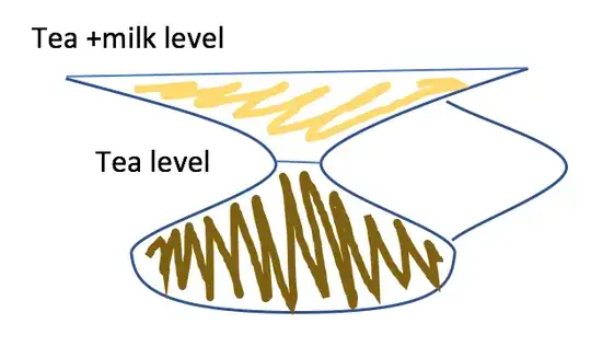

Possible factors that would change this: - the milk is VERY cold, so it can gain heat by being exposed to the room - the room is very hot - again, same effect on the milk - the cup has a strange shape, in which the addition of the milk greatly increases the surface area. This would speed up the evaporation. Since rate of evaporation is proportional to the saturated vapor pressure and therefore approximately follows an exponential law in temperature (Clausius-Clapeyron), you would have to work hard to shape a cup such that this mattered. A cup with a very narrow opening at the "tea only" level, and much wider at the "tea plus milk" level, might just do it:
With the figures you gave, you would expect the temperature of the tea right after mixing with milk to be about 43 °C. The relative rate of heat loss between that and 80 °C is roughly given by the ratio of vapor pressures:
$$\frac{P_1}{P_2} = \frac{e^{-L/RT_1}}{e^{-L/RT_2}} = e^{-\frac{L}{R}\left(\frac{1}{T_1}-\frac{1}{T_2}\right)}\approx 0.18$$
So if the surface area is at least 5x bigger, adding the milk will cause the tea to cool faster...
