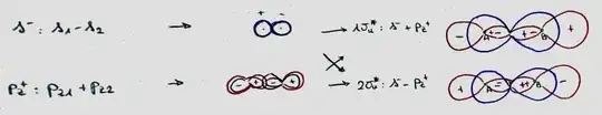

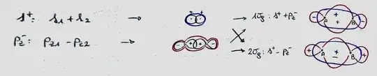

Bonding orbitals for a biatomic molecule using as a basis set the shell $n=2$.
Antibonding orbitals for the same molecule.
Now you have a sort of "ladder" of molecular orbitals and you know if each step is bonding or not. You can now put the electrons (same number as the sum of the electrons that where in the atomic orbitals you used in your basis set) as you did for isolated atoms: from bottom to top, two electrons in each level, antiparallel spin, and so on (the same rules also if you have more levels at the same energy).
You can now go back to a classical chemistry framework using the so called bond order: $$ BO =1/2( n-n^*)$$ where $n$ is the number of electrons in bonding orbitals and $n^*$ is the number of electrons in antibonding orbitals (non bonding orbitals just doesn't count). The bond order tells (if it is an integer) how many bonds we represent in a classical picture, thus going back to the concept of octet rule.

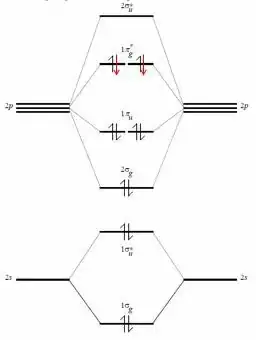

In fact, consider the valence shell of oxygen. It is made by the atomic orbitals $2s$, $2p_x$, $2p_y$, $2p_z$ and it contains six electrons. By combining these (and ignoring the interaction between $2s$ and $2p_z$, that could be possible and that only modifies the energy of these molecular orbitals) you get $4\times 2$ molecular orbitals (the apex * means that they are antibonding).
Molecular orbitals for the valence shell of oxygen.
The electrons for oxygen are black (red ones are added when considering the F$_2$ molecule).
The bonding molecular orbitals from a shell of this type are four, therefore the total of the bonding electrons are eight. Here comes the octet rule, but this kind of reasoning is trying to fit an empirical and wrong way of reasoning into a more powerful and quantum framework.
