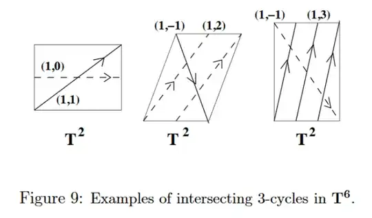

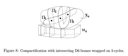

The existence of multiple generations of fermions is naturally explained in intersecting D-brane models in type II string theory. Here the observable particle content is localized at intersection points of D6-branes that fill 4d spacetime and otherwise are given by 3-manifolds in a compact 6d space.
But, generically, if 3d submanifolds inside a compact ambient 6d space intersect once, they also intersect a finite positive number of further timesenter image description here
See around p. 12 in
  • Angel Uranga, "Model building in IIA: Intersecting brane worlds", 2012 (pdf)
from where the above pictures are taken.

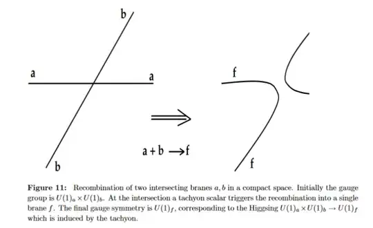

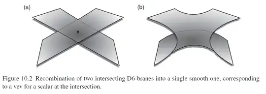

Notably the presence of a Higgs mechanism is naturally explained by the pertrubative QFT shadow of the process of brane recombination at the intersection points:
This is explained in section 7 of
  • D. Cremades, Luis Ibáñez, F. Marchesano, "Intersecting brane models of particle physics and the Higgs mechanism", JHEP, 0207, 022 2002 (arXiv:hep-th/0203160)
from which the last picture above is taken. See also Fig. 10.2 in the textbook
