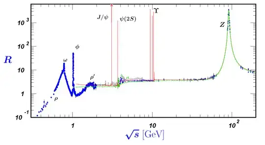

I figured that we could observe the cross section of the hadron jet process and compare at specific centres of mass $\sqrt{s}$ to known experimental results (in plot below) form the ratio,
$$ R= \frac{e^+e^- \to hadrons} {e^+e^- \to \mu^+\mu^-} $$
If we were clever about picking $\sqrt{s}$ then perhaps results could peak at a meson production process that we would be aware of and then hence, we could determine the final state energy and momentum (this is the really hand wavy bit as I don't actually know how one might do that!)

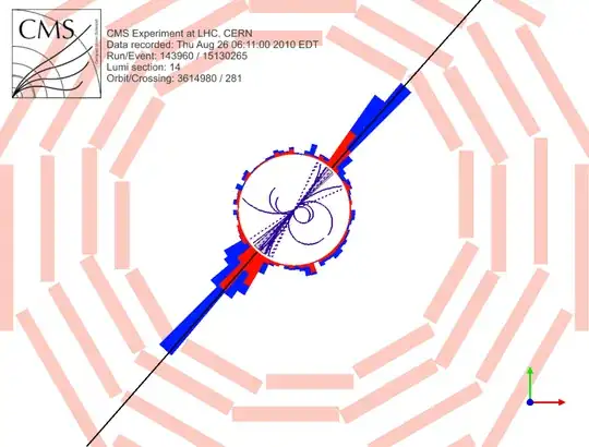

To get the individual energy or momentum of one particle, i.e. just the quark (or antiquark), we rely on the fact that they come out of the detector in opposite directions. That means it's easy to separate the outgoing particles into two clusters: one came from the quark and one came from the antiquark. You can then add up the energies and momenta within each jet to find the momentum of the quark or antiquark that produced it.
This image, which I found on Quantum Diaries, shows the kind of separation I'm talking about. Fair warning, though: this particular image came from a proton-proton collision, which means there's a bit of extra "junk" emitted in all directions, as you can see by looking between the jets. That doesn't happen much in electron-positron collisions. Unfortunately I couldn't find a better picture to illustrate it.
CMS dijet

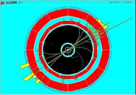

To complete David's answer, here is a two jet event in LEP, an e+e- collider, the ALEPH detector. The experiment is running on the Z mass.
The central part of ALEPH consists of several different tracking detectors. The points where charged particles interact with the tracking detectors (hits) are shown as squares and the tracks fitted to the hits are drawn as thin lines. The outer part of ALEPH consists of calorimeters, i.e. detector components that measure the energy of the particles. The total energy deposited per calorimeter cell is drawn as a histogram. For penetrating particles (muons) one can see the hits in tracking chambers of the outermost calorimeter (hadron calorimeter) and muon detectors. There are also some blue hits. These originate from particles for which the trajectory does not point back to the vertex or which have low momentum.
The beam is perpendicular to the plane of the images.
two jet
A 2-jet event resulting from the Z decaying into two quarks

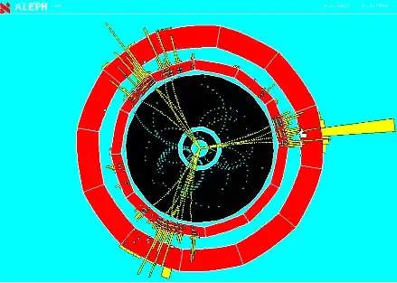

and a three jet event
three jet
A 3-jet event coming from a Z decaying into two quarks and one gluon
