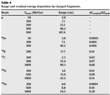

On the surface of the Moon, the main source of radiation is energetic solar particles (mostly protons and electrons) and galactic cosmic rays (GCR). (The GCRs come out of the Solar system.) The gamma radiation (as a primary particle) is negligible. (The gamma flux in the space is very low...)
According to this article, most of the particle showers won't penetrate more than 0.5 m of lunar soil (with a density of 1.4 g/cm$^3$). (According to this presentation, the density of lunar soil ranges from about 1 g/cm$^3$ to 2 g/cm$^3$.) The showers have a sharp peak in the [energy deposit - penetration depth] relationship. After which the energy deposition usually drops to less than 10% of the peak value. (Only lightly ionizing particles remain.)
Although they couldn't study the contribution of neutrons (created in the particle showers), which can penetrate more rock than the charged secondary particles. (On current spacecrafts, 30-60% of the total equivalent dose might come from neutrons.)
Based on the article, about 0.5-1 m of soil might be sufficient.
Although the radiation level will be still higher than on the surface of Earth, it is hard to tell more without experiments or simulations. The problem is with the neutrons (and high energy muons). For these, the energy loss is not continuous, but characterized by discrete events. Thus they can often penetrate more material than expected by continuous energy deposit approximation. Thus also non-trivial if '8 km' of air can be substituted by 4 m of rock (as suggested by @CuriousOne). (Also partly because of the different composition of rock and air.)
