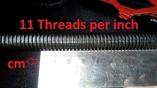

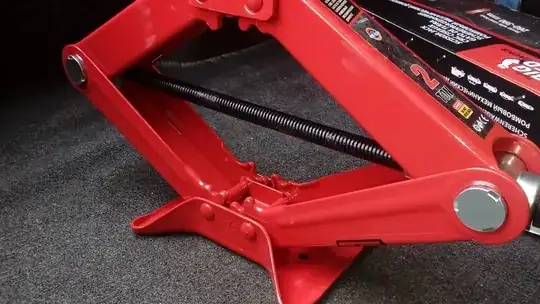

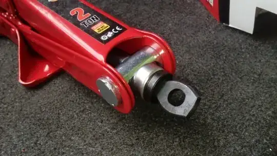

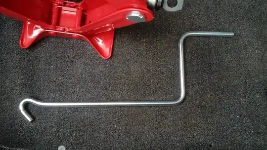

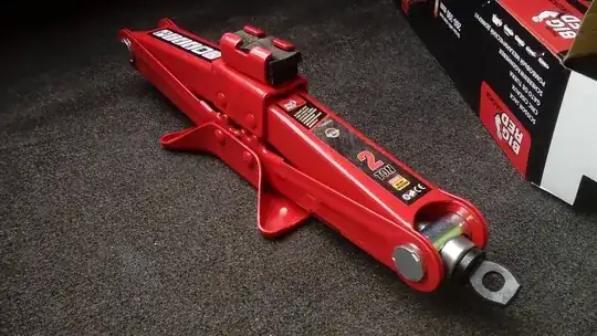

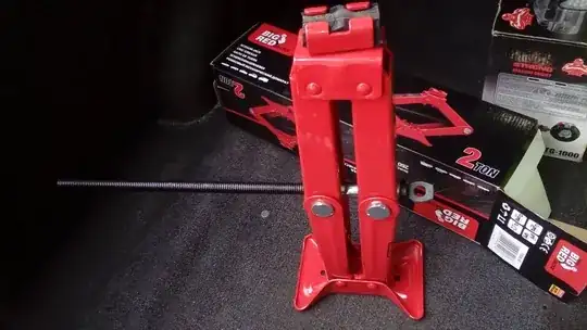

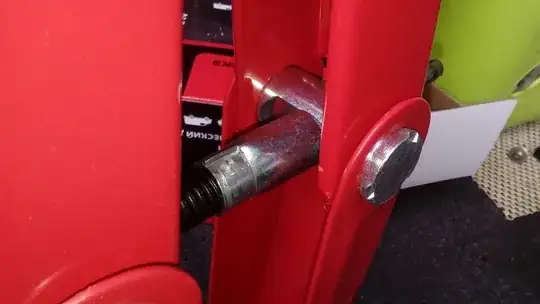

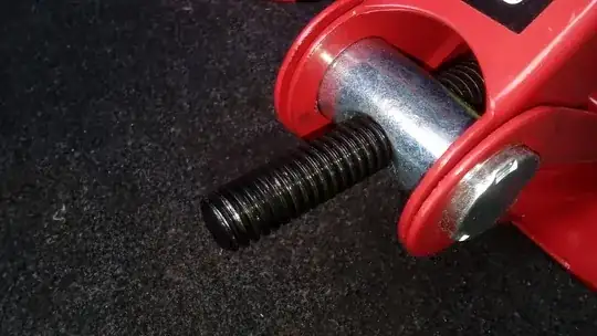

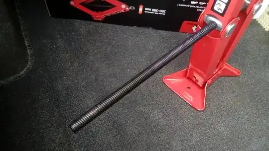

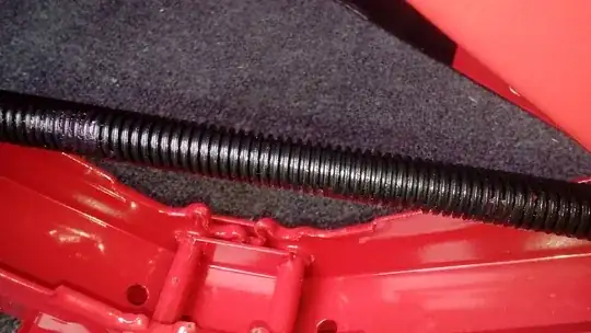

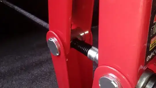

Recently, I bought a 2 Ton Big Red scissor jack. My car weighs around 1.2 ton and each front corner of the car is no heavier than 650 - 700 kg. However, it requires so much effort to turn the jack handle and it really struggles to lift the tires off the ground so that you can change or rotate them. I had read many positive reviews about Big Red jacks and paid almost a fortune for this product but now I'm indeed disappointed with my purchase. (Even my cheap Chinese jack was better than this). I tried applying grease to its threads to make it perform better but that didn't make a difference either. Why is it rated at 2 ton capacity if it can't lift as low as 650 - 700 kg?
Here are some pictures of the jack as requested:

The scissor jack needs the maximum input force at its lowest position, similar to the principle of levers. If you consider an "ideal structure" with components of zero thickness, the scissor jack at its bottom position will need an infinite force applied horizontally to make it begin to rise vertically.
An analysis of the force is shown in Scissor Lifting Elevator Mechanism, which summarises:
The maximum force needed when the angle theta [between the struts] is minimum.
This is distinct from the pitch of the screw used to raise it, the force from which is independent of the height raised.
Frankly, the scissor jack isn't a very good design. There are other designs that need a constant force regardless of the height raised. In the days when I carried a tool box in my car, it would include a simple hydraulic jack.
