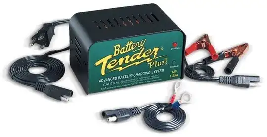

This is absolutely the right way to go! I'm not sure about the model, I'm just talking about a battery tender in general. A lot of people who own performance vehicles or recreational vehicles (RV's) here in the States will put one on their vehicle over the winter if it is a summer only driver. The tender will do exactly what you want. It keeps the battery fully charged without issue, plus they are fairly inexpensive. I think the only caveat with them is, you need to disconnect them from the battery before you start the vehicle. It's pretty easy though. Most of them come with a connector which you tie into your charging system of the vehicle. You just leave the pig tail attached to your car, then attach the tender when you want to leave the car go. Here is an example of one we would have here in the states:
While looking at the picture, the coiled part in front of the tender is the part you attach to your charging system (one connection goes to the positive either at the battery or some other "hot" point and the other one connects to ground/earth).
I'm not sure if you utilize 120v or 240v power utility in South Africa, so you'll have to ensure the one you get has that ability, but would assume any auto parts store there would have one which would work great for your purposes. There is another option if the vehicle is stored outside and uncovered, there is one which uses solar power. You plug it into your cigarette lighter or power outlet in your car, then throw the solar panel (or place lightly, actually) onto your dash. The system does the rest and does it well.
Which ever way you go, just buying one battery tender will pay for itself with one use.
