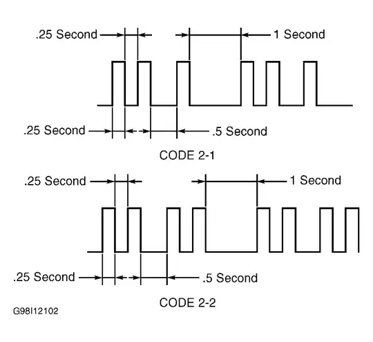

  • If the registration was complete and system is operating normally when ignition key was removed from ignition lock cylinder, the SECURITY indicator light should flash. If ignition key registration was not completed with Engine Control Module (ECM) in automatic registration mode, a code 2-1 will be displayed by SECURITY indicator light. When inserting an already registered ignition key, a code 2-2 will be displayed by SECURITY indicator light.

  • enter image description here
