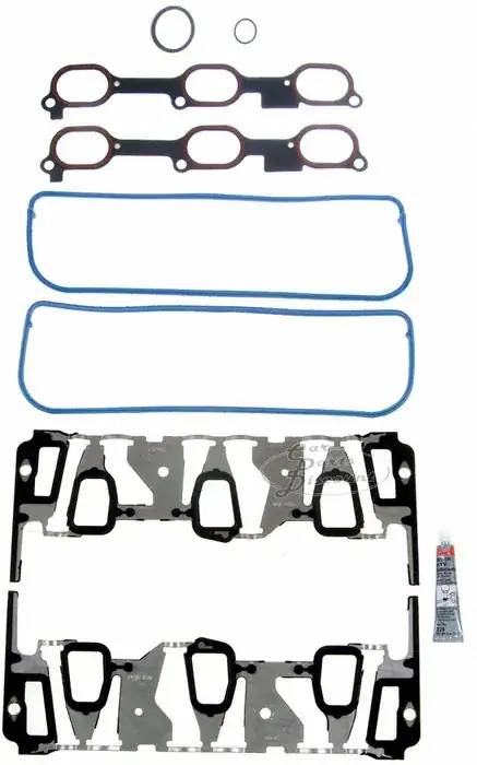

Oil found inside the Cooling System is typically caused by leaking Intake Manifold Gaskets and sometimes the Intake Manifold itself is cracked/damaged. It is a very common issue with these vehicles. It's not a job I would recommend someone do at home unless you have the tools and experience to confidently perform the repair.
Here is an example of what the intake gasket set looks like. You didn't list engine size in your original post.
