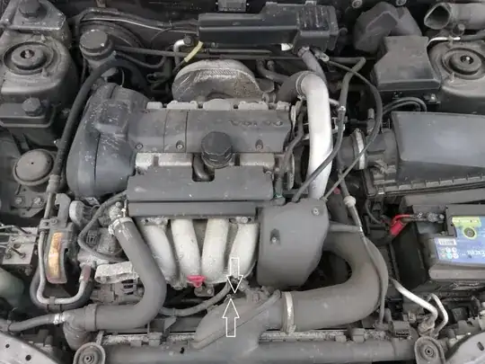

Finally, this photo is not of my engine but shows a pipe pointed at by the arrows. I have noticed some oil (I think or maybe water) around where that pipe connects and wondered what the pipe is for as it may help me diagnose the problems:
Thank you in advance for any advice.
