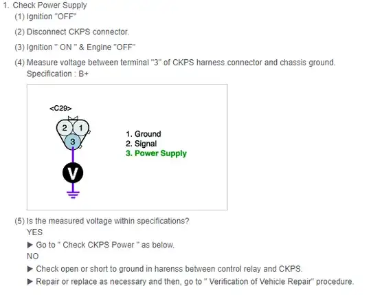

Power supply meets specification: B+ Power Supply Circuit Inspection

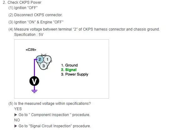

CKPS Power meets specification: 4.98V
CKPS Power Supply Circuit Inspection

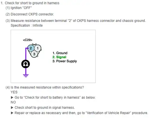

Signal Circuit check for short to ground in harness: DMM reads 0.25 ohms Signal Short to ground in harness

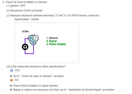

Signal Circuit check for short to battery harness: DMM reads 0.45 ohm
Signal Short to battery harness

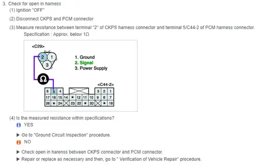

Signal Circuit check for open in harness: DMM reads between 0.1 ohms and 0.2 ohms and makes the continuity sound
Signal Circuit open in harness

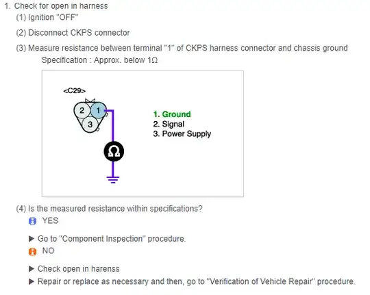

Ground Circuit Inspection : DMM reads 0.1 ohms and makes the continuity sound
Ground Circuit check for open in harness
