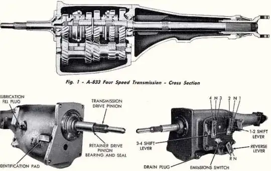

Manual transmissions (most, but not all) lubricate not through a pump, but through the action of the gears and secondarily through the level of the transmission fluid itself. In some transmissions, the lower gears in the transmission, which touch the pool of fluid at the bottom of the transmission, transfers fluid through contact to the upper gears. In this situation, since the output to the drive axles is still attached to the gears, even when the transmission is in neutral, the fluid still flows.
EDIT: Checking through many different transmission layouts, it also become apparent the level of the fluid is high enough to be right at the level of the main shaft in the transmission. In some transmissions where the lay shaft (as @Narcotixs pointed out) doesn't have gears actually turning, the amount of transmission fluid in the gear box allows for the lubrication of any moving parts.
This representative image (sorry, best I could find on Google) shows the location of the fill plug in relationship to the main shaft. Most manual transmissions will have this same relationship between the fill plug and the main shaft.
Manual transmission fill plug location.
/EDIT
