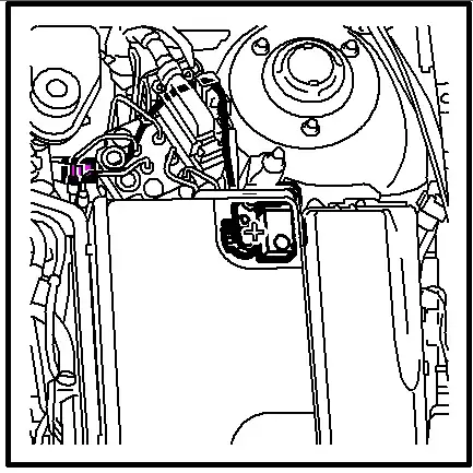

See if the battery disconnect switch needs resetting. Look on top of the + terminal of the battery. If it has red showing in the window then press the yellow button to reset. WIS: "The battery disconnector cuts off voltage from components of the front engine harness, i.e. generator, starter motor and the front relay and fuse box relay, in the event of a head-on collision. The battery disconnector cuts off current in the areas of high temperatures and high currents."
