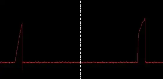

Another thing to check would be a short in the primary coil of each ignition coil. If you pull fuse 1 in the underdash fuse box and put in a loop you can attach a DC Inductive Amp Clamp and scope the current draw of all the ignition coils. It's best to get as high of a resolution as you can. I'll typically set the sweep time to 10ms.
A short in the primary coil looks like...
This isn't from a Honda but it's basically what you should expect. On the left the coil ramp is good. On the right you can see a sudden spike in current.
