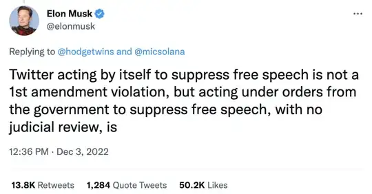

I'm trying to better understand this comment (and its implications):
In a pure hypothetical (so as to avoid any speculation on whether or not it happened), if the US Government were to be found to have ordered a private media company to suppress a story (or stories), would that kind of behaviour constitute a violation of the first amendment, and if so, what are the possible consequences (e.g. is the a range of penalties)?
