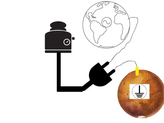

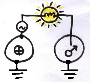

Could you use a hot wire (120v 60 hz) from earth and a copper rod inserted into another extraterrestial body (mars) to complete a circuit? If impedance wasn't something to worry about (pretend Mars is only a mile away or something).
I've asked this before on other places and got some really conflicting answers.

For all intents and purposes, no.
"Earth" connections work by virtue of the fact that all the earth-rods inserted in the ground of a single planet are effectively connected together through the planet's crust. The connection isn't necessarily perfect (e.g. 0Ω, but it's fairly low impedance).
Since the earth and mars are electrically isolated from each other by many millions of kilometers of extremely hard vacuum, there would be no path for the current to return through. As such, you would wind up with something that acted very much like a capacitor, as Wouter van Ooijen said.

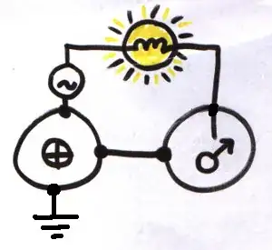

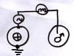

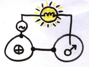

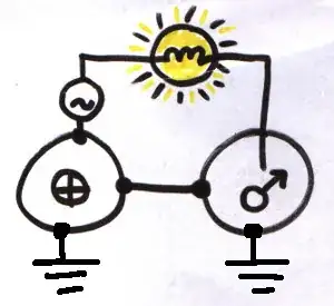

It depends on the return ground or on the question whether you complete the circuit, using the words from the question.
The confusing part in your picture is the A.C. generator: It is shown without its two terminals and surrounded by the equipotential waters of the Atlantic Ocean. Therefore, all the current it creates will stay right in the Ocean. Another potentially (pun intended) misleading detail of your question is the earth/ground symbol on Mars, and I suspect this is the root of your troubles. Thus, ...
I have taken the freedom to rearrange your setup, just using another picture for the generator, with two terminals. One end of the generator is connected to Earth (ⴲ), the other one goes to a light bulb and from there to Mars (♂), complete with the copper rod you mention. Note that the light bulb remains unlit ("off").
If you want current to flow and the light bulb to be on, you need a return wire, closing the circuit like this:
For the circuit to work, you don't need anything to be grounded or earthed, what you need is a whole circuit where the current can flow in a loop. For the fun of it, let's use the earth/ground symbol arbitrarily and create one circuit that's Earthed and one that's Marsed. Note that this is just an additional symbol used at our discretion to obtain a common reference for the entire thing - it is not something we need for the circuit to work.
Earthed Circuit
Marsed Circuit
What we really needed for the circuit to work was the return wire from Mars to Earth. This return wire actually puts Mars and Earth at the same potential, so we can even consider Earth to be marsed and Mars to be earthed - this is still the same arrangement, no matter if we use no, one or two Earth/Ground symbols:
Earthed and Marsed Circuit
Now, there may be one last question left: What happens if we use a Ground symbol in the first picture, the one without the return wire? Like this:
Or this:
Well, the bulb stays off. Again: It is not the symbol, it is the return wire that's needed, and we don't have it in either of the last two pictures.

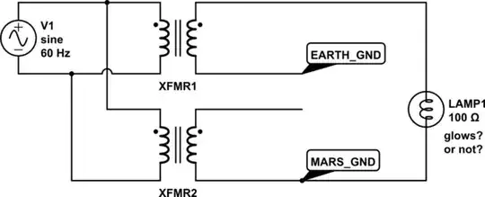

It's better to abandon the word "ground". One node of your circuit is earthed, the other is marsed. These are separate grounds.
We don't have to go to space to create disconnected grounds. In the following scheme, V1 supplies 120 VRMS at 60 Hz, and that XFMR1 and XFMR2 are 1:1 isolation transformers. Each one creates its own electrical domain where a node can be identified as ground, and another as "hot". Current cannot flow from the "hot" in one domain and the ground in the other, for the lack of a complete circuit, and so the lamp cannot glow.
schematic

    This would be right if earth_gnd and mars_gnd had no capacitance, i.e. the voltages were completely floating. But this is not the case, these planets have huge amounts of capacitance and will strongly resist change in voltages. If mars_gnd is coincidentally the same voltage as earth_gnd, even if they are not physically connected, that lamp will light up as current flows from the source to mars_gnd. It will charge mars_gnd, but the planet is so huge that the voltage wont change significantly. – travisbartley Aug 20 '13 at 05:37
