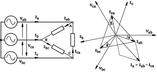

Maybe study the phasor diagram for a delta load with a slightly lagging power factor (denoted by \$\Phi\$): -
Image from here.
If the power factor were 0°, \$I_{ab}\$ would be exactly in phase with \$V_{ab}\$. So, \$I_{ab}\$ can be called a phase current because it applies to the current that travels down the specific load phase directly connected between A and B. But, the line current (\$I_{a}\$) also involves \$I_{ca}\$; specifically \$I_{ac}\$ (the reverse of \$I_{ca}\$).
Thus, \$I_{a}=I_{ab}+I_{ac}\$.
I only have a question about the lagging power factor of 0.9, is it the angle of the phase current or the angle of the line current?
The PF angle is the angle of the phase current \$I_{ab}\$ relative to line voltage \$V_{ab}\$. Ditto for the other two pairs of phasors.
