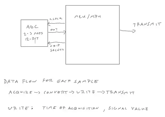

I'm a phd student in aeronautical engineering, and I'm designing a custom sensor device for my research. I've figured out the initial stage of the device, which involves converting the analog signal from my sensor to a digital signal using an ADC. At this stage, I've selected TI's ADS7047 for its compact size, differential input, and high sampling rate (2-3 MSPS). I've attached a very basic diagram of the device and what I am trying to accomplish.
At this stage, I'm trying to learn what to look for in selecting a device to drive the ADC and transmit my data to a wireless receiver. For my application, I am targeting the ability to write and transmit each data point individually, matching the sampling rate of the ADC. At this point, I'm hoping to learn: 1) what type of SoC device would be the best to use for driving the ADC and writing the data to transmit, 2) what parameters or capabilities should I be looking for to achieve the processing speeds that I am targeting (acquire, convert, write, and transmit 2-3 million samples/data points per second), and 3) how can I determine the bit rate required for my application (sending one data point file every 300-500 ns)?

    Why is there a separate ADC? Many MCUs can have built-in differential ADC with better specs, so selecting a proper MCU you can skip the ADC to begin with, so in theory you have an XY problem, the problem is not selecting a best MCU for ADC but best tools for the whole job. – Justme Dec 23 '20 at 08:14

    @Justme That's a very fair question. So far, I've mostly looked at a separate ADC because the specs are easier to identify when looking through a large list of parts. Some manufacturers don't have ADC sample rate as a parameter in product selection tables for MCUs... – scpaulson42 Dec 23 '20 at 16:38

I will start by saying that this looks like a better fit for a low end FPGA (like an Artix-7 or Spartan-7) rather than an MCU. But in any case I will address which kinds of MCUs might be appropriate first.
The ADS7047 uses a SPI bus. The datasheet says that you can achieve 3Msps with a SPI clock of 60Mhz.

  1. what type of SoC device would be the best to use for driving the ADC and writing the data to transmit
For many lower end MCUs (like PIC or AVR, PIC32 or AVR32) the SPI clock is limited to 1/4th the system clock frequency. To get a 60MHz SPI clock you would need to use a 240MHz oscillator. But those kind of parts don't support using an internal clock at that speed. A parallel output (rather than SPI) ADC would be better suited if you plan to use a lower end MCU. But don't use a lower end MCU because you won't be able to process the samples anyways.
Going yet more powerful would be something like an ARM cortex M7 or A9 MCU or a Power PC MCU. They might support SPI clocks close to 60MHz. But servicing 3 million SPI transfers per second is going to consume A LOT (if not most) of the CPU time.

  • Would you be more specific why this is more a job for an FPGA? And why handling 3 Msps of ADC data takes a lot of CPU time, as at that speeds DMA is anyway used whether SPI or whatever interface is used. And many MCUs already have built-in ADCs that support DMA. – Justme Dec 23 '20 at 08:18
  • @user4574 Thank you very much for your detailed response! To clarify, a parallel output ADC is one that has a separate output pin for each bit, correct? I've also seen recommendations for using an MCU with an integrated ADC. How would that impact the required processing power of the MCU? – scpaulson42 Dec 23 '20 at 16:58
  • @scpaulson42 Yes a parallel output ADC has a separate data line for each bit. You can retrieve the entire sample using one read of an IO port rather than one bit at a time. I recently did a project using a parallel ADC storing 8-bit samples at 2Msps using an AVR MCU running at 20MHz and there was processing power to spare (but not enough to run something like wireless also). – user4574 Dec 23 '20 at 17:14
  • @scpaulson42 Using an integrated ADC offers advantages in that reading the samples out of a register is usually quick and there may be greater integration with the DMA or other features in the MCU. There are some MCUs that offer internal ADCs with sample rates at 2~3Msps but most of them don't. Internal ADCs also tend to have worse specifications than external ones. Also like you said, the ADC specs are typically not listed in the product tables when selecting an MCU so it becomes hard to find one with the right specs. – user4574 Dec 23 '20 at 17:21
