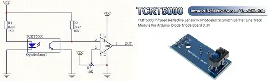

I am working on a project that uses a TCRT5000 reflective optical sensor.
Sensor datasheet is here
test circuit
I tested this sensor in a room, the voltage at the output pin is high it is above 2.5V. While showing my hands, this voltage is reduces to below 1V.
When I tested this sensor in daylight, without any obstacles the voltage is below 500mV.
  • Is there an error in testing?
  • Does the daylight affect the sensor reading?
  • How can I use this sensor in both indoor and outdoor applications?

Appendix A - TCRT5000 Module Schemetic
tcrt5000 schematic

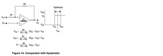

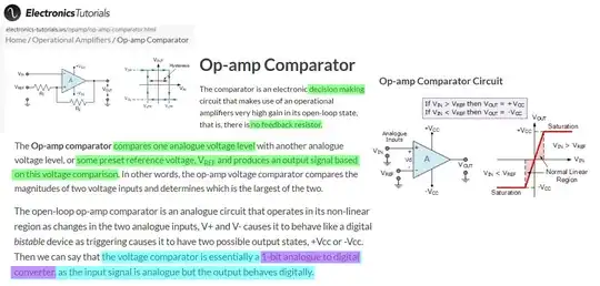

Appendix B - Op-amp Comparator
op amp comparator
LM324 Single Supply Quad Op-amp Datasheet - Fairchild
lm324 comparator
