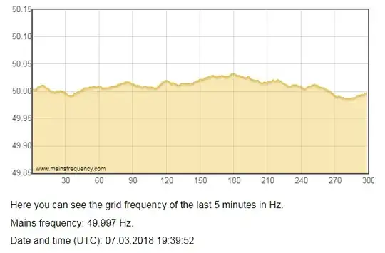

    Right, @Trevor_G: More pretty pictures for you. I'm having to look all this stuff up as I don't work in the power industry. It's rather interesting but if I'm tired in work tomorrow it's your fault. – Transistor Mar 07 '18 at 23:20
