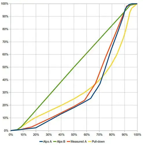

For illustration, here's a plot I made comparing linear pot, log taper pots, and linear pot with "pull-down resistor" to approximate a log taper. I'd like something that will plot the yellow curve, for different values of the pull-down resistor, so I can make it behave as closely as possible to the other curves, without having to enter an equation manually. Of course, my real applications are more complex, but this is an example of what I want to do.
