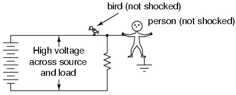

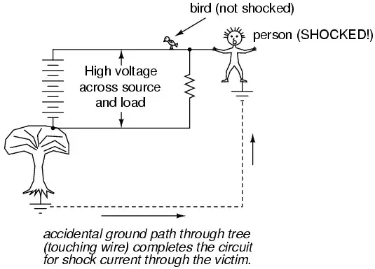

  3. The article on a website mentions that in this circuit enter image description here
the guy does not get electrocuted, but in this image enter image description here
he does get electrocuted. Why is this? In the first Image the person is connected to ground (0) and is also holding the the high voltage line (240V), so the electrons/current would want to flow through him I would assume?

In the first Image the person is connected to ground (0) and is also holding the the high voltage line (240V), so the electrons/current would want to flow through him i would assume?
Notice that in the first picture, the power source is not connected to ground, so the unlucky guy's foot connected to ground doesn't produce any path for current to flow back to the power source.
In the second picture, both the guy and the power source are (indirectly) connected to ground, so there is a complete circuit formed through the guy and the ground, and the guy is not going to have a good day.

  • Still dont fully understand the third question... Am I wrong in thinking that there is a potential difference in the first picture (240V to 0V), leading to current being able to to flow through the person? Would it be different if it was DC? – lijas Aug 07 '17 at 18:36
  • No, the power source only produces a potential difference between the two terminals it's connected to. It can't force a potential between either terminal and earth without being connected to earth. (But see the scenarios in the linked page involving trees for cases where either of the two terminals might be grounded by a fault causing the other one to become hot relative to ground) – The Photon Aug 07 '17 at 18:46
  • So I made the circuit in the images with a battary as the power source, a LED as the guy, and a resistor as the load. I did not know what to use as ground, but I used my right and left hand as some sort of ground (what else could i use?). The diod lit up (very dimly) if I used the circuit in image 2 and was dark if I used the circuit in image 1 (as predicted). What would happen if the ground the tree touches and the ground the guy touches (in image 2) were very very far apart (which I guess can be normal)? Does the two ground need to be connected to each other in some way? – lijas Aug 07 '17 at 20:04
  • The earth has poor conductivity but high cross-sectional area, so it can be used to carry substantial currents. See Single-wire earth return, for example. – The Photon Aug 07 '17 at 20:17
  • RE: "Does the two ground need to be connected to each other in some way?". Yes, see Can a circuit be powered from Earth with a return ground on Mars? – The Photon Aug 07 '17 at 20:22

  3. In the first image, the source is not grounded. There isn't a complete circuit.
    The source is floating, or in other words, isolated.

You should know that the current always flows in a closed path, since you know what fuse is. The current leaving +ve of battery has to somehow return back to the negative, then only the circuit be complete and current would flow. In the first image the circuit is not complete as the "High Voltage" doesn't have a common ground with the person. The current doesn't flow through him. If the current would want to flow though him then from where will it return back to the battery? There is no path for the current to flow back to the battery. Its like saying the circuit is insulated from ground. As you become insulated by sitting on a wooden chair. You will just hurt yourself from the fork getting heated up. Human body offers about 2000 oh
