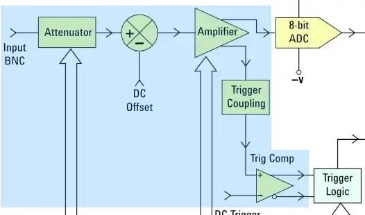

See this Keysight document on Scope fundamentals for EE Students. On page 17 you find a typical block diagram of an oscilloscope, page 18 and 19 mention the relationship between bandwidth and sample rate.
From page 17, part of the block diagram (the blueish part is determines the analog bandwidth):
A block diagram: the analog bandwidth determining parts of an digital oscilloscope are highlighted with blue (source: keysight)
From page 18:
  • All oscilloscopes exhibit a low-pass frequency response.
  • The frequency where an input sine wave is attenuated by 3 dB defines the scope’s bandwidth.
From page 19:
  • Required BW for analog applications: ≥ 3X highest sine wave frequency.
  • Required BW for digital applications: ≥ 5X highest digital clock rate.
  • More accurate BW determination based on signal edge speeds (refer to “Bandwidth” application note listed at end of presentation)

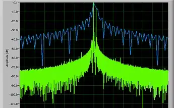

DSO's serve many many functions as measurement devices in both Time and frequency domain. Factors which affect the quality of the signal capture are not just the fundmantal but even for a pure sinewave, the spectral SNR is important for many applications/
One method is defining a signal is the FFT defined by span and resolution. This is where a high ratio of Sampling rate to Signal Bandwidth is useful. This higher rato reduces the Resolution bandwidth in an FFT.
Effects of higher Sampling Rate and lower Resolution Bandwidth improved resolution is lower Noise per Root Hz Bandwidth. The more samples per bin, the lower the noise floor as shown below.
